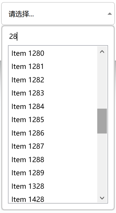

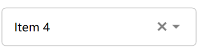

因为项目中PC端前端针对基础数据选择时的下拉列表做了懒加载控件,PC端使用现成的组件,为保持两端的选择方式统一,WPF客户端上也需要使用懒加载的下拉选择。
WPF这种懒加载的控件未找到现成可用的组件,于是自己封装了一个懒加载和支持模糊过滤的下拉列表控件,控件使用了虚拟化加载,解决了大数据量时的渲染数据卡顿问题,下面是完整的代码和示例:

160         <Popup
161             x:Name="PART_Popup"
162             AllowsTransparency="True"
163             PlacementTarget="{Binding ElementName=PART_Toggle}"
164             PopupAnimation="Fade"
165             StaysOpen="False">
166             <!--  AllowsTransparency 启用透明,PopupAnimation 弹窗动画  -->
167             <Border Width="{Binding ActualWidth, ElementName=PART_Toggle}" Style="{StaticResource PopupBorder}">
168                 <Border.Effect>
169                     <DropShadowEffect
170                         BlurRadius="15"
171                         Opacity="0.7"
172                         ShadowDepth="0"
173                         Color="#e6e6e6" />
174                 </Border.Effect>
175                 <Grid Height="300">
176                     <Grid.RowDefinitions>
177                         <RowDefinition Height="Auto" />
178                         <RowDefinition Height="*" />
179                     </Grid.RowDefinitions>
180                     <!--  搜索框  -->
181                     <TextBox
182                         x:Name="PART_SearchBox"
183                         Margin="0,0,0,8"
184                         VerticalAlignment="Center"
185                         Style="{StaticResource WatermarkTextBox}"
186                         TextChanged="OnSearchChanged" />
187                     <!--  列表  -->
188                     <ListBox
189                         x:Name="PART_List"
190                         Grid.Row="1"
191                         DisplayMemberPath="ItemText"
192                         ItemsSource="{Binding Items, RelativeSource={RelativeSource AncestorType=UserControl}}"
193                         ScrollViewer.CanContentScroll="True"
194                         ScrollViewer.ScrollChanged="OnScroll"
195                         SelectionChanged="OnSelectionChanged"
196                         VirtualizingStackPanel.IsVirtualizing="True"
197                         VirtualizingStackPanel.VirtualizationMode="Recycling" />
198                 </Grid>
199             </Border>
200         </Popup>
201     </Grid>
202 </UserControl>
 1  public partial class LazyComboBox : UserControl, INotifyPropertyChanged
 2  {
 3      public static readonly DependencyProperty ItemsProviderProperty =
 4          DependencyProperty.Register(nameof(ItemsProvider), typeof(ILazyDataProvider<ComboItem>),
 5              typeof(LazyComboBox), new PropertyMetadata(null));
 6
 7      public ILazyDataProvider<ComboItem> ItemsProvider
 8      {
 9          get => (ILazyDataProvider<ComboItem>)GetValue(ItemsProviderProperty);
10          set => SetValue(ItemsProviderProperty, value);
11      }
12
13      public static readonly DependencyProperty SelectedItemProperty =
14          DependencyProperty.Register(nameof(SelectedItem), typeof(ComboItem),
15              typeof(LazyComboBox),
16              new FrameworkPropertyMetadata(null, FrameworkPropertyMetadataOptions.BindsTwoWayByDefault, OnSelectedItemChanged));
17
18      public ComboItem SelectedItem
19      {
20          get => (ComboItem)GetValue(SelectedItemProperty);
21          set => SetValue(SelectedItemProperty, value);
22      }
23
24      private static void OnSelectedItemChanged(DependencyObject d, DependencyPropertyChangedEventArgs e)
25      {
26          if (d is LazyComboBox ctrl)
27          {
28              ctrl.Notify(nameof(DisplayText));
29          }
30      }
31
32      public ObservableCollection<ComboItem> Items { get; } = new ObservableCollection<ComboItem>();
33      private string _currentFilter = "";
34      private int _currentPage = 0;
35      private const int PageSize = 30;
36      public bool HasMore { get; private set; }
37      public string DisplayText => SelectedItem?.ItemText ?? "请选择...";
38
39      public LazyComboBox()
40      {
41          InitializeComponent();
42      }
43
44      public event PropertyChangedEventHandler PropertyChanged;
45      private void Notify(string prop) => PropertyChanged?.Invoke(this, new PropertyChangedEventArgs(prop));
46
47      private async void LoadPage(int pageIndex)
48      {
49          if (ItemsProvider == null) return;
50          var result = await ItemsProvider.FetchAsync(_currentFilter, pageIndex, PageSize);
51          if (pageIndex == 0) Items.Clear();
52          foreach (var it in result.Items) Items.Add(it);
53          HasMore = result.HasMore;
54          PART_Popup.IsOpen = true;
55      }
56
57      private void OnClearClick(object sender, RoutedEventArgs e)
58      {
59          e.Handled = true;  // 阻止事件冒泡,不触发 Toggle 打开
60          SelectedItem = null; // 清空选中
61          Notify(nameof(DisplayText)); // 刷新按钮文本
62          PART_Popup.IsOpen = false;   // 确保关掉弹窗
63      }
64
65      private void OnToggleClick(object sender, RoutedEventArgs e)
66      {
67          _currentPage = 0;
68          LoadPage(0);
69          PART_Popup.IsOpen = true;
70      }
71
72      private void OnSearchChanged(object sender, TextChangedEventArgs e)
73      {
74          _currentFilter = PART_SearchBox.Text;
75          _currentPage = 0;
76          LoadPage(0);
77      }
78
79      private void OnScroll(object sender, ScrollChangedEventArgs e)
80      {
81          if (!HasMore) return;
82          if (e.VerticalOffset >= e.ExtentHeight - e.ViewportHeight - 2)
83              LoadPage(++_currentPage);
84      }
85
86      private void OnSelectionChanged(object sender, SelectionChangedEventArgs e)
87      {
88          if (PART_List.SelectedItem is ComboItem item)
89          {
90              SelectedItem = item;
91              Notify(nameof(DisplayText));
92              PART_Popup.IsOpen = false;
93          }
94      }
95  }

四、效果图
 转自https://www.cnblogs.com/adingfirstlove/p/18855065
