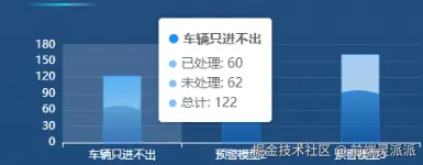

首先要实现基本配置,柱子的高度为数据的总数,水波的位置为已处理数据,提示窗展示名称、已处理、未处理、总数等数据。
// 数据配置 - 包含已处理和未处理的数据 const chartData = [  { name: "车辆只进不出", processed: 60, unprocessed: 62, total: 122 },  { name: "预警模型2", processed: 72, unprocessed: 82, total: 154 },  { name: "预警模型3", processed: 71, unprocessed: 91, total: 162 } ]; // 创建水波柱状图配置 const createOption = () => {  return {    backgroundColor: 'transparent', //echart背景为透明    animation: false,    tooltip: { //提示窗配置      trigger: 'axis',      axisPointer: {        type: 'shadow'      },      formatter: function(params) {        const data = chartData[params[0].dataIndex];        return `${params[0].name}<br/>已处理: ${data.processed}<br/>未处理: ${data.unprocessed}<br/>总计:${data.total}`;      }    },    grid: { //图表位置占比配置,尽量居中      left: '3%',      right: '4%',      bottom: '12%',      top:'5%',      containLabel: true    },    xAxis: {  //配置x轴      type: 'category',      data: chartData.map(item => item.name),      axisLabel: {        color: '#fff',        fontSize: 12      },      axisLine: {        lineStyle: {          color: '#fff'        }      }    },    yAxis: { //配置y轴      type: 'value',      axisLabel: {        color: '#fff',        fontSize: 12,      },      axisLine: {        lineStyle: {          color: '#fff'        }      },      splitLine: {        lineStyle: {          color: 'rgba(255, 255, 255, 0.1)'        }      }    },    series:series //配置数据项  }; };

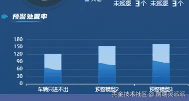

创建echart图标,并实现水波的动画效果
// 创建图表 const createChart = () => {  const container = chartRef.value;  chartInstance = echarts.init(container);    chartInstance.setOption(createOption());    // 启动水波动画  const animate = () => {    animationTime += 0.1;    if (chartInstance) {      chartInstance.setOption({series:series});    }        requestAnimationFrame(animate);  };    animate(); }; onMounted(() => {  createChart(); }); onUnmounted(() => {  if (chartInstance) {    chartInstance.dispose();    chartInstance = null;  } });
最终效果:
